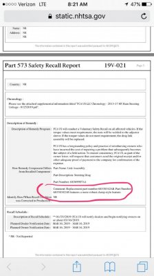

drag link part# I also have seen it mentioned on many posts and found documentation from Chrysler to support this, I will try to upload a
photo of it. I have to thank you though your the first person to be really clear about what the replacement is and show photo's of it. I was
able to locate one at a dealer about 45 min. from me that had one in stock, now to try and get reimbursed from Chrysler. Also if you read
the replacement procedure in the recall it says the torque specs are (Pitman arm end 27 ft.lbs. plus 180 degrees and steering knuckle end
44 ft.lbs. plus 105 degrees) I don't know why they can't just give you a final torque # it seemed to work fine in the past. Anyway thanks
again, the replacement drag link design seems to be a perfect solution and end to this issue. FullSizeR.jpg
