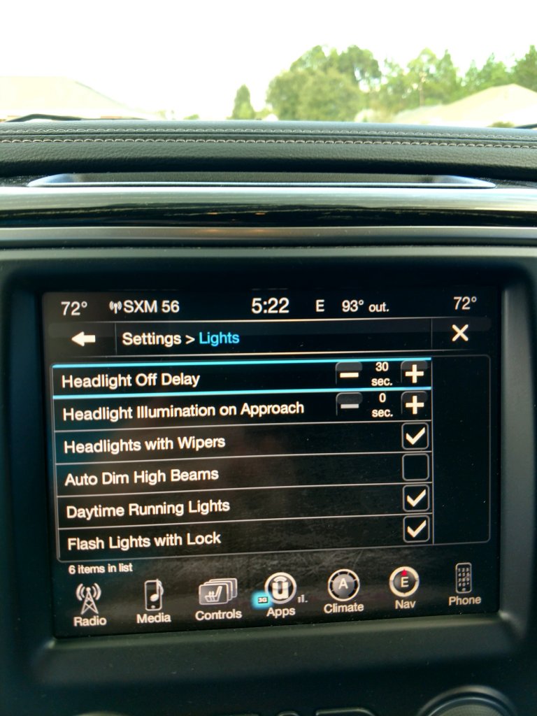

16' Express owner here and I have the toggle on the 8.4 to enable and disable after using Alfa. Tried every setting but prefer the signals as DRLs.

Were you able to get the on/off toggle in your light settings?

Well the OBDLink-MX showed up today and using the AlfaOBD app in less than 5 minutes I changed the configuration of the DRL output to the signal lights and disabled the fog light dropout with high beams so they stay on! Looking forward to exploring more options.

Also I figured I would add I just turned on the DRL on a 2016 Ram 1500 Limited and it got the toggle on/off through the 8.4 radio. Did this using the Alfaobd software.

I want that on my 2017 8.4
