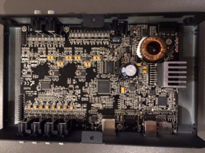

You can file this one under "If you wanted to know" what the inside of the DEQ.8 looked like.
attachment.php
Since there is no remote (though it does have a remote port) I was hoping to learn if they implemented any of the IR Remote circuitry that can usually be found on MiniDSP boards but it does not appear so to me. I do have a message into Ryan at Soundstream if the wired remote port is as simplistic as what I have been reading on MiniDSP forums, a simple temporary short to cycle configs and volume up and down. I am not brave enough to test my theory yet because I kind of like my DSP ;) so hopefully he will shed some light.
Ultimately I would like the ability to switch configurations, one TA, one not TA when passengers are onboard, which is often. I could go the tablet route but something a little quicker and simplistic would be nice.....like other DSP's. :(
