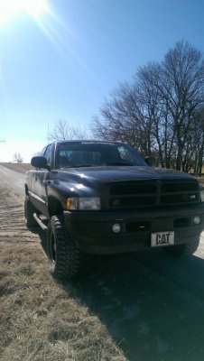

Wait, it says maintains ride QUALITY...and it says LEVELING right in the title...doh.
For replacing some suspension components AND getting a lift? That's a deal to me. Any pics of your rig?
These dont do the kit justice. It looks lower in the pics than in person. Just something to keep in mine. Im running 285/75/16's.
I understand, my truck looks short in pictures.
Anywerds, I like it a lot. Im on 245 tires (about 31.8"). Thanks for the recommendation!
