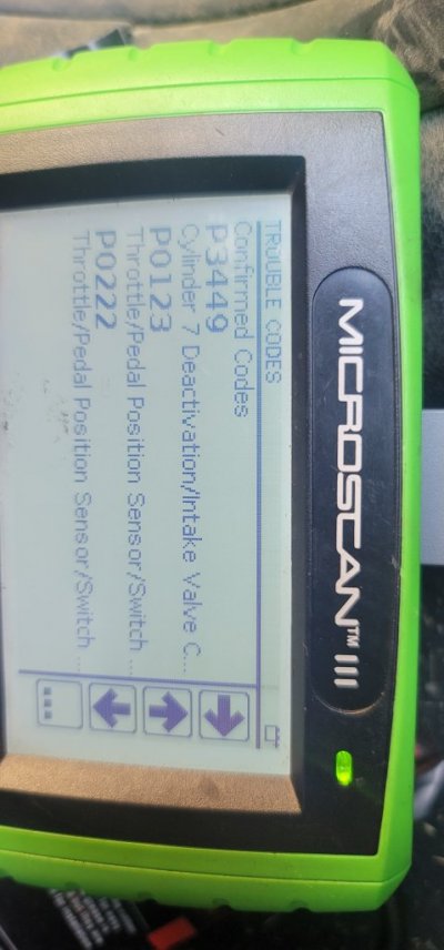

Have a 2017 Lone Star 5.7 hemi. Have had issues that I thought would have disappeared with replacement of ignition coils, spark plugs, deactivation solenoids, camshaft and crankshaft position sensors. As to this point the codes are still there. The main codes are the deactivation ones and now getting a misfire in cylinder 7. I have been told that the ECU is vehicle specific even though part number are the same for many years. Is it possible to get a new ECU and plug it in without programming it? Possible to get a salvage one and save a few bucks? Thanks for any help.

Just picking the next piece. I changed all items that the codes were referring to. As I mentioned. I replaced all ignition coils and sparkplugs when I got the misfire code in cylinder 7. Still there. Changed all 4 deactivation solenoids. Still there. Camshaft and crankshaft sensors. Still there. I was just trying to go to the next item that controls them. I don't know why the codes are not clearing. I have pulled the battery to let it reset. Codes go away on the first start but after I shut off and restart there they are again.

You can’t just change the part that the code refers too. The codes don’t mean that part is faulty, it means there’s an issue with that system. You still have to diagnose what’s wrong.
What are the actual codes you getting? Like the PXXXX. That will help.

For the MDS codes I’d be looking at the intermediate connector by the back of the intake. I’d be testing all the wiring from the PCM to the solenoid to make sure there is no opens or shorts.
Have the lifters ever been changed? Possibly swapped for non mds lifters?
For the cam issue, have you taken out the VCT solenoid underneath the intake. It’s somewhat common for the screens on the solenoid to come apart.

Yes. Will say there's a misfire in cylinder 7 along with all the deactivation errors.
Ok, with all those codes I would really be looking at a wiring harness issue first. PCM failures are really not that common on these trucks. You’re going to have to test all the circuits from the PCM. Thats what I would be doing if I came across this at my shop.
