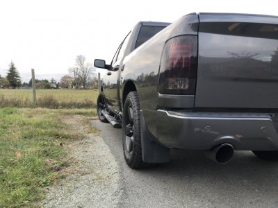

Booms summed it up nicely, I will agree if you are keeping stock sized wheels and tires then the 2” drop looks good and is functional and cheap. You just need spring for a couple hundred bucks.
If you go to bigger rims and lower profile. The 2” drop isn’t enough and it looks goofy like mine is right now. Here’s a 2” rear drop with stocks and then 24” rims on a 4x4
