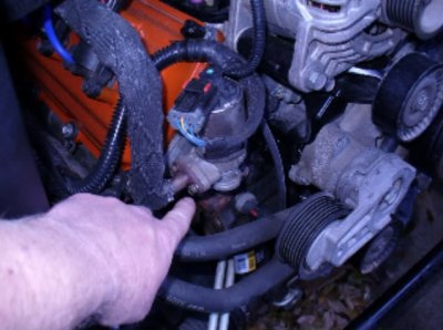

Hello, I am a first timer at this and I'm learning. I am putting back together an engine after a complete rebuild for the first time and I cannot, for the life of me, find the plug for the top of the egr. Engine is in a 04 ram 1500 with a 5.7l. Ive looked and looked but I can't find the appropriate plug. Where does the wire originate from and is there any landmarks to look for when searching?
All of the videos ive watched and forums I visit all say that it is suppozed to be coming from the passenger side but like I've said, I can't find any lone wires with an appropriate plug. All other wires and plugs I can find on the wiring harness are accounted for.
Its a mystery.

Sure it's not under the intake manifold by mistake? Maybe caught under something? Should be attached to the alternator harness (see pic).
