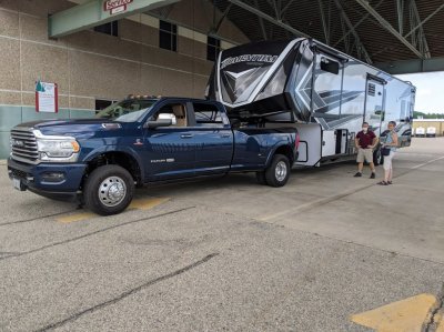

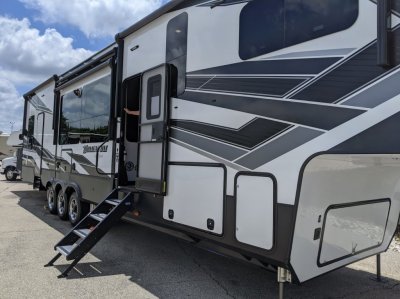

After a few COVID related delays, I finally logged my first 50 "loaded" break-in miles. New Grand Design Momentum 397TH toy hauler. My wife in the "pilot car" behind me had to remind me a few times to stick to break-in speed limit. Another 150 coming up this weekend on our first "close to home" camping trip. After tent camping for 50+ years, this is going to be a different experience!
