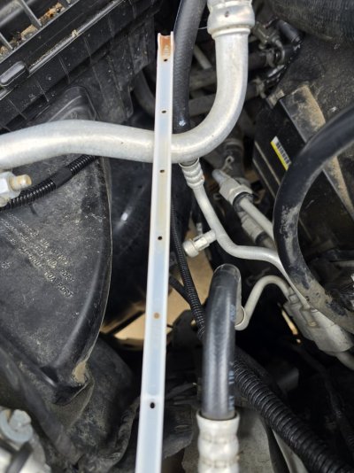

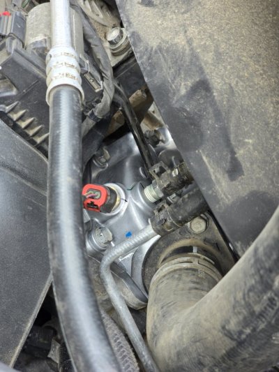

This is what I have. There is a small coolant line that comes out of it. When I bought it it had a nipple where the plug usually is. Found a picture of the pump if that helps. Not 100% exact but shows the connection sticking out.
On your truck,follow Kens tip of loosening off the temp sensor,but be careful,they are prone to breaking if you go all Bohunk on them
I'll make sure I am careful when loosening the sensor. Don't need a new problem. I'll report back the outcome.

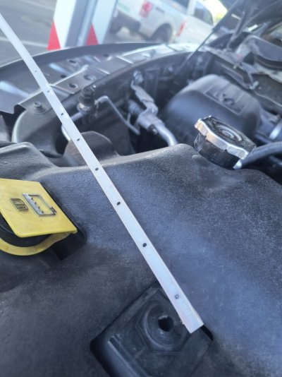

Next question; is the brown crap on the coolant dipstick normal? The brown stuff was darker but I cleaned it off when I changed the water pump. From max line to the tip it looked like what the tip does. Is it just from sitting in the reserve for 7 years?
Checked the fan clutch. Crawled under the truck and moved the fan back and forth but it had no play and made no noise. Gave it a good spin and it rotated maybe once. Noticed a bit of resistance when spinning. Then did the newspaper method. Which I though meant going in the newspaper and looking for a new truck :anitoof: Sorry about the fan the ac was on.

My dipstick is clean, except for the Kool aid purple of the coolant.
Also, I put a sharpie mark on a fan blade and gave it a spin. I got half a rotation.
