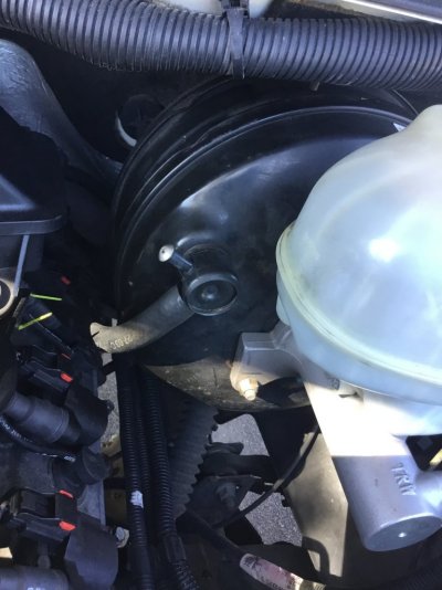

My EVAP issue was the plug on the 1/4” brake booster relief valve blew off. I just plugged it with a short machine screw. Fixed my problem.
