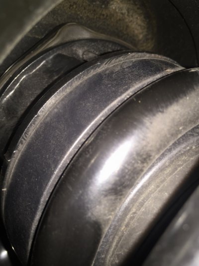

Here's mine, with a spacer on it... If yours looks like this, your spacers weren't removed. I would ask them how in the hell they did that.

I don't know. I will probably take it back on Tuesday to have it checked out. But wouldn't the Bils set at 2.8 and a 2.5 inch spacer make it a lot higher than 41 inches? If there are no spacers in the front and everything is correct I am going to have to have them removed and reset to 2.1.
Do you know your measurements front and back prior to the bilsteins install with the 2.5" spacers ?
Wer you level prior to the bils install ?
If so then I'd say they did leave the spacers in .
I've heard of guys installing bils with spacers to achieve more lift , so it is possible .
Those who've done this typically have bad vibes especially in 4 wheel drive and their upper ball joints don't last long either .
Not sure how an alignment can raise the front end dramatically without issues driving .
You should be able to tell if the spacers are installed , could you take some closeup pics of the upper end of the coil and spring area , it's not real visible but you should be able to see it .

People really do that? Lol... And this was a 2.5" spacer, that's really crammed in there if so.

I didn't look at it prior to install so I'm not sure what is normal and what is not. Is that a spacer above the last coil?

Seriously? Son of a! I heard people say that Bilsteins were tighter but driving home I was like, this does not feel tighter at all! I thought maybe it was tighter if I went over bumps.

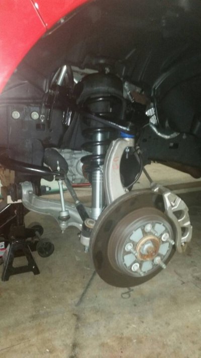

This is mine that I installed @2.8 , no spacer. ..
And the stock setup prior to the bills .

Yeah, my springs look more compressed than yours.
My tire isn't installed and no weight on them , I'm still on Jacks .

So the more I look at it the more I think that spacer is still in there. I picked up my truck after they were closed up and gone. I will definitely take it back this week. Thanks for your help!
