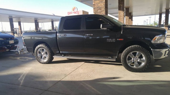

Did some towing the other day and getting new tires, so I figured I'd show what the rear end looks like...
This is 2.8 in the front, tires are BFG AT KO2 285/65R20, and pulling a Ford Focus on a U-Haul auto carrier... Not too much rear sag, got about 15mpg according to the dash.
Sent from my LG-H810 using Tapatalk

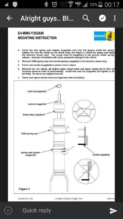

Everything Bilstien Mega Thread
Shaft washer plate nut.. Correct?
Also you guys leaving the sleeve on or taking the sleeves off?
R.L.K.
Dec 1, 2013
12,803
12,508
Bristol , Tn.
Shaft washer plate nut .. Correct ?
Check this out .
Look at note 5 &6 .
