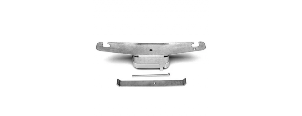

Plug in the block heater and install a 120 Volt in car warmer. Much easier on the engine, takes less than 2 minutes to warm up, and you never have to scrape your windows again. Far easier to plug the truck in than beat it up with cold starts. You also save a ton in fuel costs. Have been using this combination for over 40 years. Just run the extension cord through the firewall, use an awl to punch a hole in the boot the hood cabe goes through, and plug it into the same multi plug extension you plug the block heater in with. I keep them both plugged in permanently and wrap the extension cord on the winch with a rig you can get from zerosart for 10 bucks. You can see the blue extension coed wrapped on the left side. You can also mount it to the grill or bumper.
