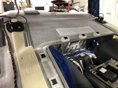

Yes they do pop off. But clips that hold them are all metal and pretty stout. They didn’t want them falling on somebody’s head. So if you can for the very first removal, drop your headliner enough to squeeze the top part of the clips. You can use an extra long pair of needle nose pliers. You can get a pair at any auto parts store. The ones i use where curved at the end. After that unless you really pull the clips prongs back out, they will be easier to remove. Three are under little white covers but they are the same clips. You would be much better off and less likely to break them if you squeeze them first. Cause I’m not saying that isn’t a possibility to break them but technically you should be able to pull them out. It’s just a lot of pressure on the headliner to do it. Removing the c post and b post trim is easy. Then it will drop down enough to get to.

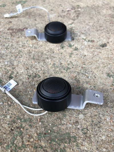

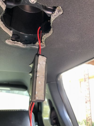

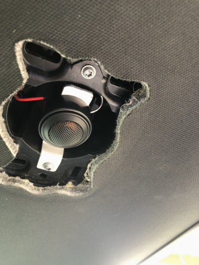

I replaced mine with these...
https://www.crutchfield.com/p_109CL750TM/JBL-Club-750T.html
They sound awesome but with the resistor packs they came with, they were kinda quiet so I removed the resistors. Now they sound louder. They’re a 3 ohm. Not really totally sure what ohm the factory ones are but these that I have were recommended by Crutchfield.
Here’s my custom brackets I made.

that's not a resistor pack that came with them, it's a capacitor, to cross over the signal and protect your speakers from low frequencies that will blow them
Hmm. Maybe I oughta just take them out then and put the stockers back up there. Those little JBL’s I bought are three ohm and more than likely the factory ones up there are just 2 ohm like the rest of the factory speakers. With that capacitor or whatever it is... this thing....
...you could barely hear them. Almost to the point of being 80 bucks wasted. You can hear them good now and at pretty high volumes they don’t crackle so I guess I’m doin alright. But if they blow, I’ll just put the regular ones back in.
