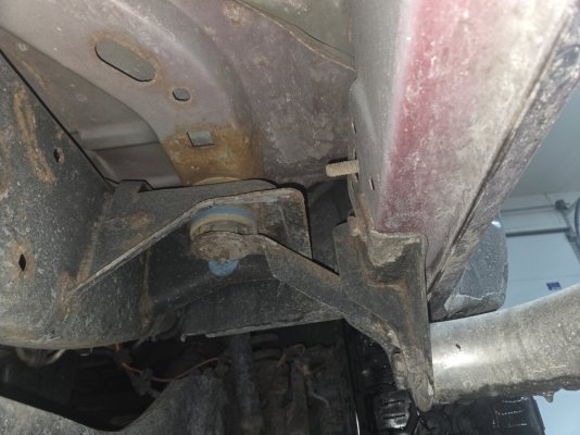

I dont know if the bars on my truck are OEM or aftermarket (they were on there when i bought it) but they tie into the cab mounts on the frame and i got to say ...these are the most solid need bars i have ever seen
Ever
OEM ones I've had have only attached to the body, so they're likely aftermarket. I personally haven't seen any that attach to the cab mounts.

It was a first for me too, but I love em (not a fan of the bars themselves, they could have been a lil wider) but not are they solid
