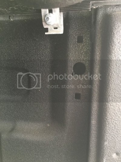

So if I have the holes in my 15 would the wiring be there? I'd like to add the factory lights like the 16's
My 15 was a late build. Build date was 4/15
Here's the holes in my bed
Anyone know?

'16 2500 Laramie. Factory installed. They do not come on when you open the tailgate and there is no manual switch on the lights or anywhere in the bed. They do come on automatically when you lock or unlock your doors or by using the manual switch under the headlight dial. They work in tandem with the bed lights in the 3rd brake light housing.

Installed a set of the Mopar cargo lamps, but it does require them to be added to the vin, and a computer flash if you want them to work like the factory option.
