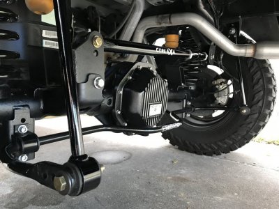

Use the top hole on the bracket for 5” coils, lower for 3”
Here’s my BDS 6” with 5” rear coils
