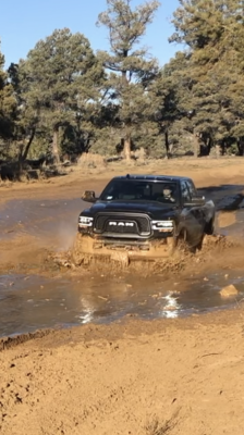

So an update on this thread and a response to 62Blazer’s reply.
I actually took it to the RAM dealer today and they said this is a common problem if any mud gets into the fan assembly area. A tech came out to talk to me because the advisor wasn't to sure but was concerned because he saw mud splatter in the engine bay. Tech said if any dirt or rocks get into the fan’s clutch assembly it will cause a sporadic heavy shaking until it falls back out. Ive never taken apart what he talking about so I dont know if this would be true. He asked me to spray it out and if the problem persisted to bring it back in and they will take it apart. Given the service advisors concerns about the mud splatter, if I bring it back I will probably just start with a manager. I drove my Sierra 2500 through plenty of mud washouts on trails and never had this issue, probably because the skid plate covers more of the front underside.

Do you have pictures of this mud hole? It sounds deep to get into your fan clutch. I have not been “mudding” in my truck in years. What got me, was the 3rd hour and 2nd roll of quarters at the car wash... I pull something that takes the beating and less quarters to wash it. Haha
Attached is what I drove and also a snap from a FCA Power Wagon commercial.
