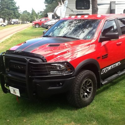

image.jpeg I bought a clearance light kit for a 2500 from mopar and used the template to drill holes in my 2016 Rebel. Low and behold the wires were under the sheet metal just waiting to be hooked up! The rebel is based on a 1500 platform so I am guessing that any 2500 should have the wire harness run for the top lights. It is still just a guess.

View attachment 132530 I bought a clearance light kit for a 2500 from mopar and used the template to drill holes in my 2016 Rebel. Low and behold the wires were under the sheet metal just waiting to be hooked up! The rebel is based on a 1500 platform so I am guessing that any 2500 should have the wire harness run for the top lights. It is still just a guess.
badass truck :rocking:
