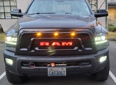

AlphaRex Luxx 5th Gen Style, to replace the OEM Projectors and match the 5th Gen Tail lights of last years Mod
However despite the post about Plug n play mostly true except DRL seems to need the included extra harness as it didn't come on as normal (Drive/Reverse)

So PnP to me means that functionality of OEM (in this case OEM Projectors) is retained when replacing with after market (added features is always a plus) My DRL was a factory setting that came on super bright Turns when the Drive or Reverse was selected, that's not the case with these, the solution AREX has is a separate DRL "Module" that you add to the wiring that enables DRL at ignition "on"
All so I'm getting B162A and B162E and Lights Drop out despite alfaODB enabled LED on Low and High Beam and disabling Bi-Xeon and HID
Oh and another annoyance, the General blogging of general install methods with pictures and general guides is fine but how about a wiring diagram especially since I had to purchase a separate harness just because I had Factory Projectors, don't get me wrong, these are great products, well made and quality work and I'm not at all regretting my purchase it's just the little things guess I'm OCD that way
Figured out the Issue - Voltage was @14v Raised it to 14.6 works fine no more Drop Outs (Tried 14.4v and worked to but went with 14.6v)
Now to Fix the DRL Harness stuff

That looks surprisingly Awesome! I can just image the "behind the Grill" cleaning routine you'll need to keep - I should do that on my Maggie
Actually, no more than I already do.
I always clean inside my hood and front when I wash it, I also take a soft bristled copper wire brush and "comb" any bugs or debris in my condenser fins very gently as not to bend any.
Then I detail the inside all over.
Mine's not a daily drive either, so it stays pretty clean anyways.
