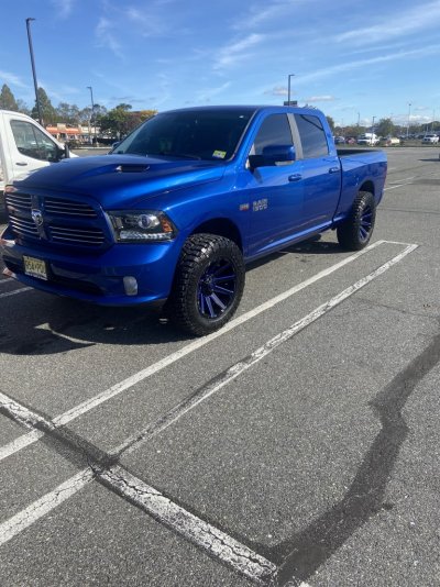

This is my first post here I’ve done a lot of reading prior to posting. Not too good at this internet stuff but I tried to attach a pic so I hope it worked. I’d just like to thank everyone for the information everyone put out here. I bought my truck in June and wanted to level it with the biggest tires I could fit. After a lot of reading I went with bilsteins at 2.8 for the level and 20x10 fuel contras with 35x12.50 -18 mm offset and patriot tires. Just slight rubbing at full lock on the inner fender wells

Welcome to the group.
Very nice looking truck !
I am not crazy about the tires rubbing sometime :O That would bother me

I remedied the tire rubbing issue. I used a zip tie to pull the inner fender well back about an inch. Thanks for the warm welcome fellas
