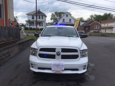

Several of the guys in my house like speedtech. I had a bar from them mounted internally across the rear of my F150 Super Crew. My new 2019 1500 Classic quad cab's rear head rest are too tall for it so I went external with a magnet mount I bought off Amazon for around $120. I had to make some mods to its wiring but I like it. I also purchased some LEDS (4 per pod - https://www.amazon.com/gp/product/B07FQF59BW/ref=ppx_od_dt_b_asin_title_s00?ie=UTF8&psc=1) and mounted them in the grill. If the 2018 is like the 2019 classic (which it is my understanding they are the same), you can mount a pod running up and down in the middle of each lower quadrant of the grill. There is a plastic air deflector that clips to the grill surround, however the clips look to be one time use only so I drilled in carefully from the front thru the openings to make an access hole for the wire as well as pre-drill for screws in order to hand screw in the mounting screws. It looks really clean and unless you are looking for them they do not tend to stand out.

note the factory setup only provides about 18in of wire from the light to the connector and the connector is not weather proof. The connector clips in to about 8 ft or wire to a cigarette lighter plug switch combo. Initially, I ended up soldering in additional wire as I purchased the extension kit from them. In the end I hard wired it down the back of the window and along the frame to the engine bay and connected it and the grill lights to the controller. I did pick up a weather pack plug kit and built a weather protected connector that I can unplug at the back window in order to be able to take the bar off the truck for car washes etc.
I'll try to get a pick an post it. I think it's a clean setup, and I like it better then having lights in the cab as I do not have to deal with the light splashback you get of the windows when you mount inside.

For whatever reason neither photo caught the driver's side grill light when lit, but you can see particularly in the straight on shot. Like I stated earlier the top light was about $120 and the grill lights were $20 all from Amazon.
I would like to get some input on whether or not I should add any graphics to the truck? I have looked at a lot, and I am not a big fan of the racing strip, but have thought of a hood application along with rear fenders (Strobe graphic) but I am not sure. Or should I just leave her pure white??? And if you think I should add a graphic what color, matte black or a colored one (I'm partial to blue)

The roof one is simply a magnet mount (4 magnetic feet). The grill are simple screw in one where cable comes out the back. I did not take pics while installing them and do not want to take grill off again. I'll try to get a close up of the mounting, but the are mounted to the plastic air deflector that is mounted on the back of the grill, i.e. it's part of the grill.

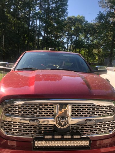

I've got a nice setup on my truck that's pretty easy to miss unless you're too close to the truck to be just passing by. I'm required to have an omnidirectional light on my roof that has a 360 degree unobstructed view. With all the other stuff on the truck, it just looks like a construction truck even with the mini light bar. I'll drop a link to my build thread that has all my specs and you can feel free to PM me with any questions.
Edit : link to build thread
https://r.tapatalk.com/shareLink?ur...share_tid=142826&share_fid=17770&share_type=t
