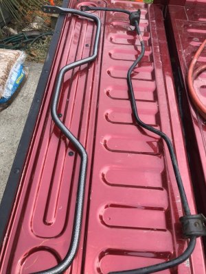

Last night I put on a Hellwig rear anti- sway bar. Can’t believe the difference it has made. My thought is to buy things I can install first that I will need before I start buying the stuff for the drop.
Does anyone know anywhere that has the front sway bar in stock? Everywhere I check says it’s 6 to 10 weeks back ordered.FD0DA398-7903-41E4-9378-3030931C321F.jpeg

In my humble opinion, you may be wasting your $$.
I put the rear hellwig on my 14 RCSB that has a 2/3 drop and inside 3 months took it off and replaced it with the roadmaster.
The rear hellwig is 7/8 inch the roadmaster is 1 1/8. Much improved and Heck of a difference in handling and no need to touch front other than shorter f150 end links to level bar. My little truck corners like it's on rails.
I was lucky, in that I have more than 1 truck so I transferred the hellwig to my stock height quad cab I use for towing otherwise I would be miffed.
Your truck your $$. I would do some research here on the forums.
Many threads. Most are excellent
Hope you work it out to your satisfaction. My experience yours will vary...

I don't think you were incorrect I just think it's about objectives, mine is handling and high speed stability your objectives might be looks and straight line performance
I was just suggesting that spending $$ on the front bar could be better researched. Your rear decision has been made.
I own 3 of these trucks and spent about $15 bucks on the front to replace end links bushings with poly bushings on 2 and maybe $45 on the third to replace end links and bushings.
I would not over think it, if you are happy and meeting your objectives then my experience is my experience.
I felt after buying the hellwig it was ineffective in meeting my objectives as I still had to much sway in the rear at higher speed. Perhaps I am over engineering but my objectives are high speed stability with the ability to run in triple digits for longer periods of time.
I live in Montana where roads are flat wide and have lower traffic volumes and higher speed is tolerated.
My final objectives include rear relocation brackets, a replacement driveshaft and drivestaft loop. All supporting handling and high speed

I went with front and rear hellwig. No regrets here yet. Still fine running to make everything work right. I'm trying to achieve a stiff ride with hard cornering abilities. Our freeways here are horrible and feel my front sway bar made it more noticeable /harsh ride.
Do you have a part number for the Roadmaster ?
