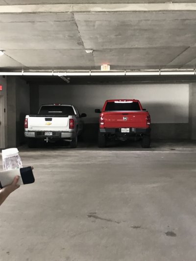

One of the biggest motivators of making them fit on a leveling kit was to be able to fit in garages. I succeeded in doing that lol

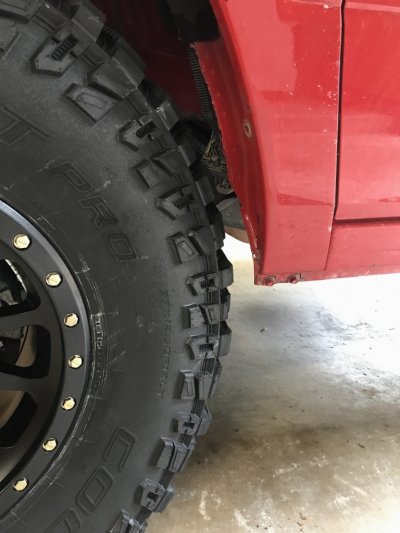

At ride height and normal driving I was surprised to find that there was no rubbing lock to lock. With that being said, I still did quite a bit of clearancing just to make sure I wouldn't have any problems

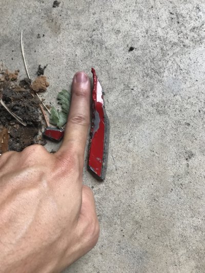

This is all I had to cut and I also moved that big ass connector you can see in the picture.
Here's the end result: Did not have to cut any of the plastic liner.
