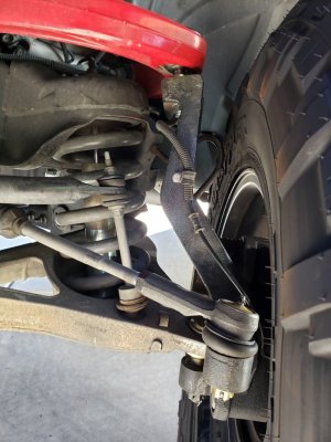

Here is a nice little shot of the joints :p
Uniball in the upper arm. Moog problem solvers in the lower and tie rod. Don't worry about the brake line. It was moved after that photo.
