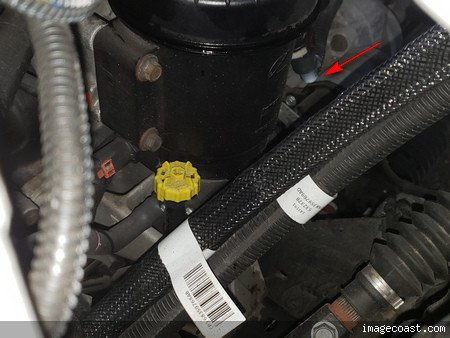

I just changed the fuel filter for the first time on my 2019 3500 Cummins HO and have a leak. Everything went smooth and it started immediately but it is leaking from the fitting shown. Does anyone know what it is and what I might have done to cause it to leak?

That is exactly what mine is doing man! It is ******* me off so much! I have taken off the top of the canister multiple times and re set the gasket after cleaning. Torqued the top exactly as it says but still the dam leak off the back at the elbow. It is the fuel supply tube is the line there with the fitting. I ordered it today to replace it and see how it goes. $80 so i will keep you posted.
Also i will attach the pic of where mine is from.

It turned out I pinched the O-ring. I reused the old one and all is well.
