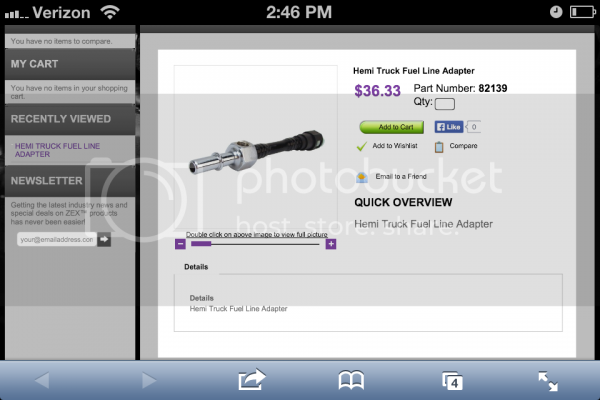

this is the one I used, easy install and is holding up well
http://www.zex.com/zx/hemi-truck-fuel-line-adapterhtml/

One more question. How did you connect this
To this
The top pic looks like a hose of some sort would connect to it. While the sensor has a 1/4" npt fitting.

the fuel line adapter has a female port on top the silver part

the fuel adapter fits inline with the fuel line - heres a pic (i got a slightly different adapter for some reason, but the way it works is the same)
