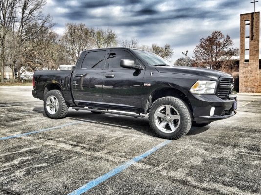

zstampe
Jul 16, 2015
516
399
you will not notice it in looks. Just to have a bigger number on the side wall- not worth it. Unless you have a odd tire size, which is not very common and hard to get, if you want bigger tires, than go bigger.
Oh really? Sound advice. These do look the exact same....... (Sarcasm) :beer:
275/60/20
275/65/20
275/60/20
275/65/20
New2Ram
May 29, 2013
70
17
Minnesota
^^^ What brand tires are those and how do you like them? They look good.
Thanks
zstampe
Jul 16, 2015
516
399
Thanks
They are Kanati Trail Hogs, they are a cheaper tire but have mostly great reviews. I love them so far, but I only have about 400 miles on them.
