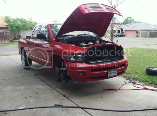

Got my headers on today!!!!
ATXHEMI
Jun 30, 2012
985
201
Round Rock Tx
2005
The beginning
Soakin the bolts
Got em off
Got em back on
The dif in parts
So much for the header paint
Video coming soon. The butt dyno approves this message.

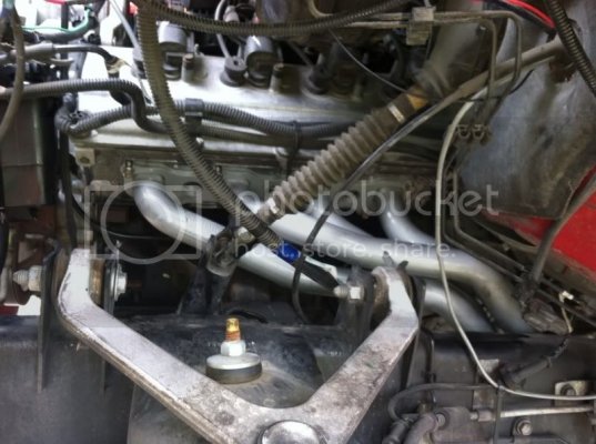

Nice how was the bolts to get out I got my soaking right now but I already broke one of the heat shields bolts on both sides same one I hope they come out easy

Great job and nice thinking on the useage of the stage 8's

I broke 3 of the heat shield studs but all the bolts came out of the head no problem. I soaked them with wd-40 twice after I got the heat shields off. I didn't paint them. I bought them that way. I was going to get ceramic coated til I came across these. It was to good a deal to pass up. And so far no cel. The non fowlers are workin. I don't think I will be able to drive with my cutout open any more. It sounds like a racecar now.
