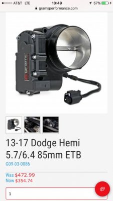

Anyone try out this throttle body? Seems to be realtively new release.....
https://gramsperformance.com/induction/throttle-body/g09-03-0086.html

Curious. Arrington and BBK has been making 85 and 90mm (ran a 90mm on a full tilt blueprinted 5.7 based 392 striker), since the LX/LC market boomed back in around 2010, what's the consensus on running one of those as well?
