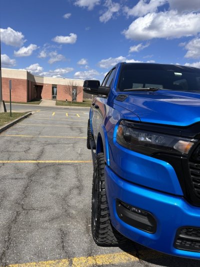

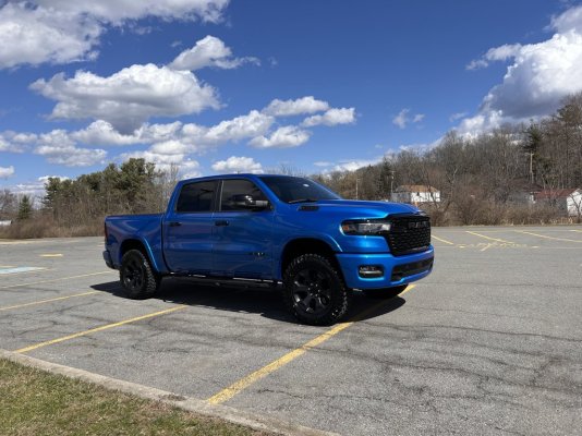

Had to fix the rake.

Rough Country 2” N3 struts.
KSP 2-4” UCA’s
1” rear StreetRays spacers
1.5” KSP wheel spacers
295/60/20 Hercules TT1’s
Minor trimming.

Looks great! The stance is perfect,IMO, I think our trucks look better lifted or lowered, I know why there made with a stance, just prefer a leveled look.
Awesome color too, beautiful truck!

Man without the rear spacers it looks like that thing would be sagging pretty bad…did the front go up more than the 2”?

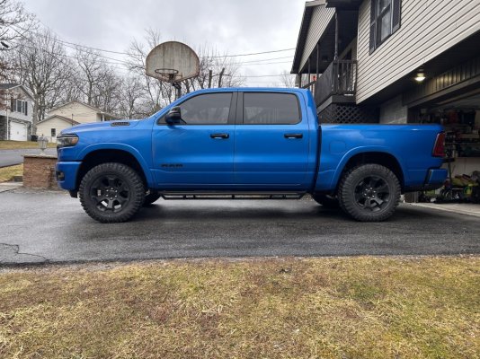

I shoulda posted a side pic for better viewing. I measured all 4 wheel wells from the ground, over center of rim to the truck. All 4 spots came in at 41 inches. I think it’s damn near perfectly level. Rear might could use 1/2 inch more but it just depends how you look at it.

Yea i agree. Thats why i was questioning if the front went up more than 2”. Most trucks have over 2” of rake from the factory.

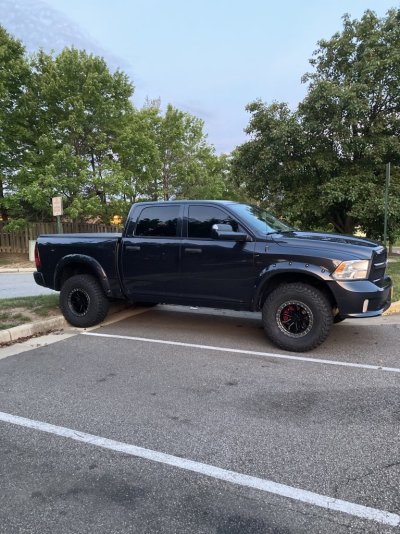

Mine is a 4th Gen, the hood sits a little higher than the bed, so a true level looks nose high.
My truck measures 3/4” lower in the front but appears level to me.
I leveled mine soon after buying it, later added some Icon 1.5” springs, ran with that stance for a couple of weeks, ended up having the struts adjusted to relevel.
If yours is nose high, not sure about the 5th Gens hoods, it’s hardly noticeable.
