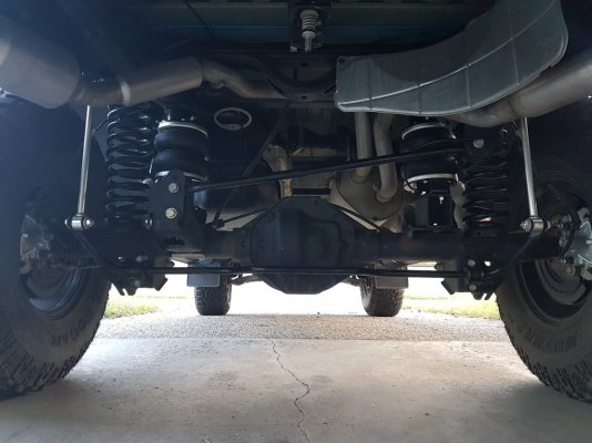

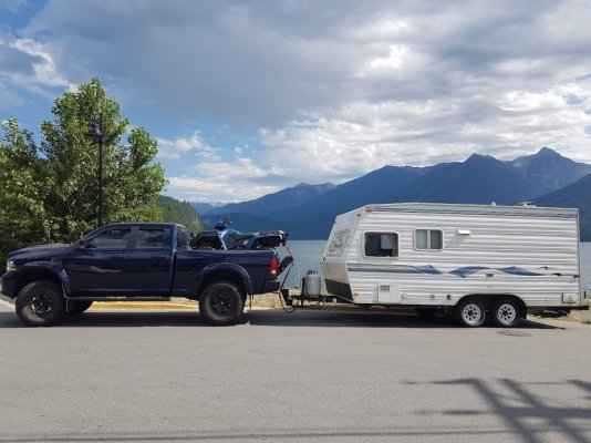

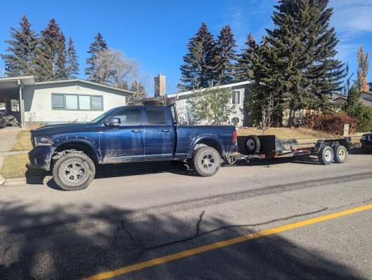

Day one purchasing my hemi in 2017 with installing a Zone 6" lift with 37's, my hemi never gave me any issues during towing and on long travel days. I made sure my trailer brakes work to help assist with braking, and give myself good room in front of me from vehicles had never made me worry once with my setup.
Having rear airbags will help enormously to maintain good front traction for steering and braking.
Many studies out there showing that this statement is false as rear air bags do nothing to transfer weight back to the steer axle with a bumper-pull style trailer - they only raise the rear end of the vehicle. Weight is only returned to the steer axle by lowering tongue weight (reducing weight behind the rear axle), either through redistribution of the weight on the trailer or a WDH.

In regards to rear airbags. In my experience they definitely help with towing especially if you have too much tongue weight which causes excessive squat. Technically they do not transfer weight from the rear to the front, but if you do have excessive rear squat it does move the center of gravity back some, which is basically shifting weight rearwards. I'm not saying they work the same as a WDH or transfer anywhere near as much weight, but they do help with weight transfer some. Airbags do not replace WDH, but they do help. Regardless of any weight transfer, having airbags on my truck make it feel much more stable and planted when towing. I don't get nearly as much sway and "porpoising" going down the freeway.
