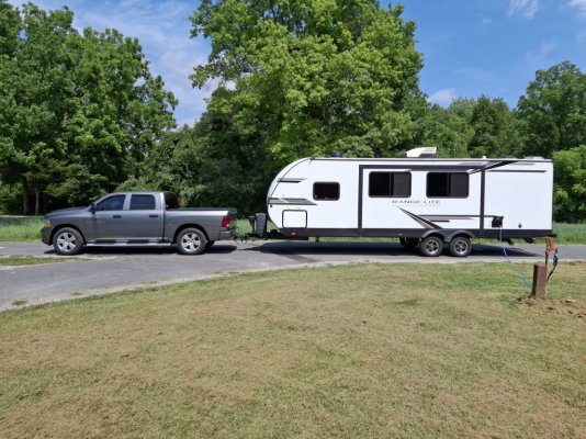

I tow a 6500lb (scaled weight) travel trailer with my 1500. tounge weight is 920lbs (scales) It does a fine job, but I wouldn't want to go any bigger than that. My truck is stock ride height with air bags. 5.7l, 6 spd, 3.55 gears. I think the lift is going to make the ride rough. Also, I get around 8.25-9.0 miles per gallon when towing.

Just curious, what are your rpms sitting at when going 60-ish on the freeway?

1500-1800. I always use tow haul mode, which keeps it in 5th gear.
Sounds about right; I have 8 speed and 3.21 and it will tow in 7th at around 1800 ish rpms if I let it, but it is really happy at 2100 to 2200 rpms and that's also "direct" drive for me so I lock it down to 6th and it cruises there for hours, lots of power left in reserve even for passing people without needing a downshift. In 7th gear I feel like there is nothing left in reserve, any time you need to dip into the pedal it downshifts.

Mine is a 6 spd, I wish I had an 8. I know what you mean, mine will downshift to 4th anytime I give it some throttle input, or slight grade.
