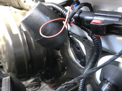

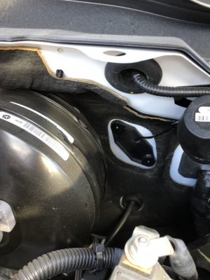

Im pulling an antenna, and sPOD cable through this piece. I currently have a small, what looks like audio cable, that is all ready pulled through the plastic shield. Anyone know what that wire is running to? I can post a picture later today.
View attachment 158555 View attachment 158556
Any wire going thru that plate is not OEM, that's the clutch pedal delete plate. You should consider using a wiring boot
https://www.ramforum.com/threads/in...wires-into-the-cab.117923/page-3#post-1968127
