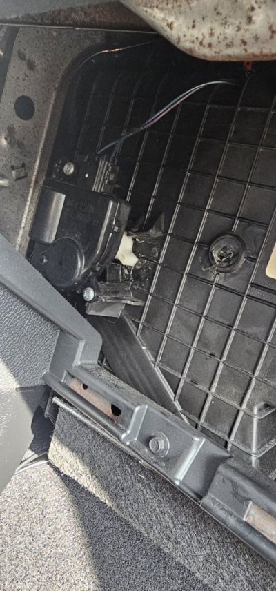

Thank you everyone for all your help trying to figure this otlut. Apparently it wasn't the Heater core, nor the bend door or the actuator it was the touch screen that I have I had a setting that turned on that I guess disabled the heat on my side.. I do now have hear after checking all the things everyone provided to check and came to a dead end I started messing with the touch screen.

Remove the motor and move the door rod by hand. Make sure it 'bottoms out' on both sides ...and stops firmly (door not broken off the rod). Move and see if you can get more heat out of the driver's side.

So I tried that, I took it off, and it gets held down by the air flow and then firmly held top when it push up I can also hear the door flopping up and down when I move it as well. So I'm assuming the door bend isn't broken

If this is a factory 8.4 dual Zone ATC climate truck, then there is a separate "passenger side" blend door motor on the back of the plenum box at the firewall you likely won't be able to access without removing the dash/plenum etc. It could be causing the issue as well.
That blend door you pictured, is the main Temp Blend Door though.

i was looking into that, but isn't that for the passenger side? the passenger side has no issue going from hot to cold, or w.e the temperature i set it too. the driver side is the one thats cold all the time. it is the 8.4 dual zone ATC.

Oh it is? , I do have another bend door, behind my radio/touch screen. I was going based off of this picture that claimed to be for the dual zone picture.png

You are correct in focusing on the actuator behind the glove box. That is the blend door actuator for the driver side. If it had gotten hotter during the engine revving, that would indicate some trapped air in the core that would have most likely originated from an active or previous cooling system leak. I will ask, with the engine up to operating temperature and the HVAC off. Are both of the heater hoses coming out of the bulkhead hot to the touch?

My eyes are not what they once were, but that actuator in Image#1, appears to be broken away from the main housing of the HVAC box.
I may be wrong ?
