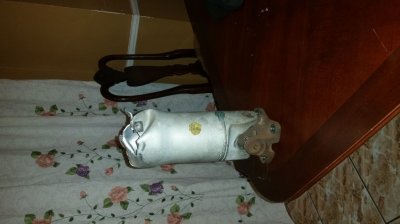

Hed the same drive shaft problem with the exhaust hanger sadly it was to late for me it's fixed now but this was the outcome
