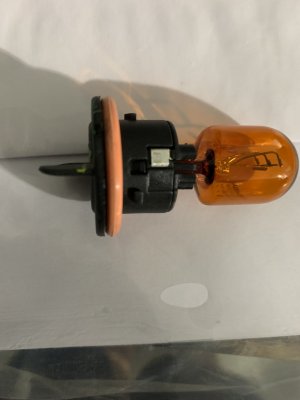

Im sure these would work on my truck, and they are similar to a few others I’ve found. The issue is, I’m trying to find something that doesn’t need the resistors. This is my fourth Ram, so unfortunately, I’m familiar with using the resistors and relays, and all the headaches that can come with changing bulbs on these trucks. The new Rams have a different type of harness than previous models. I’ll take and post a picture later when I can pull a bulb out. To sum it up, the connections are made inside the dust caps for even the turn signals now. There aren’t any wires coming out of the backside of the bulb to tap into so I’d have to tap into the headlight harness. Not that this is impossible to do, I was just hoping someone would have developed a true plug and play for these things that wouldn’t require resistors/relays.

Here are pictures of the 7440 bulbs for anyone that is unfamiliar. These new bulbs have no wires attached. They make electrical contacts at the base of the bulb and screw into the headlight housing. Hence, the desire for a plug and play bulb.
