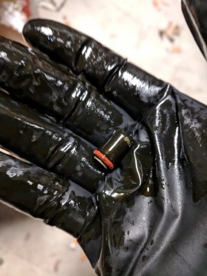

Had some time to get back at it today. Just dropped the oil pan. Had to remove the "structural dust cover" that bolts up to the bellhousing and to get that off, I had to remove the metal plate under the starter. Had to put the pan down and was able to reach right in and pull the little bugger out. Plenty of clearance at the end as you can see from the pics. It was sitting right next to the plug, but in the pan, the plug doesn't sit at the very bottom, so it would have been next to impossible to fish it out. Was worried about the gasket, but luckily it was still on there. FYI, then pickup tube does have an extremely fine screen on it, which the dealer told me it didn't... Now to figure out how to unbolt the pickup tube and get the new windage tray in...IMG_20171223_132618.jpg IMG_20171223_132549.jpg IMG_20171223_133040.jpg

You should get a gold star or something for all the crap you have had to go through getting those damn headers installed. :(

Windage tray was tricky to remove... Have to go from the front, unclip the fan shroud, position the oil pan as far left as possible and pull the windage tray out to the right. Requires some jiggling and repositioning due to the pulley and the down bolt for the pickup tube. Waiting for the fiance to get home so I can pickup some rtv sealant, but I got the new one sitting in there ready to go. I feel so relieved as it's been problem free today.
