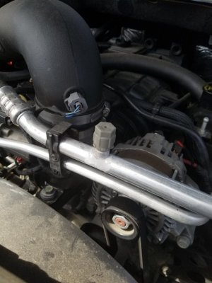

Kind of a bummer but I guess 44 isn't bad. It was 80 and sunny out today. I was cruising on the freeway getting these Temps. I did notice a stain near one of the ac ports, is this anything to worry about?
Looks like my A/C line and it's basically solder overflow from the fitting being added BP,nothing to worry about
