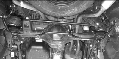

Not sure if I'm the only dummy who followed the instructions that came with the Hellwig, but the end links are supposed to go inside the bar, unlike the pictures. Guess I didn't pay close enough attention when I removed the stocker.
Unlike what pictures?

The picture on the instructions that came with the bar. I had it correct first but then looked at the pic and second guessed myself.
EDITED: I have the rear bar instructions and it shows the stock endlinks to the inside, also.
Besides, if you let the endlinks hang down, they hang to the inside anyway. I haven't seen any pics with them to the outside.

My instructions don't look like that (I have the bar for lifted applications). It shows the upper end link mounted to the outside too, so when they hang down they hang outside. I don't know how to add a damn pic on here anymore.
