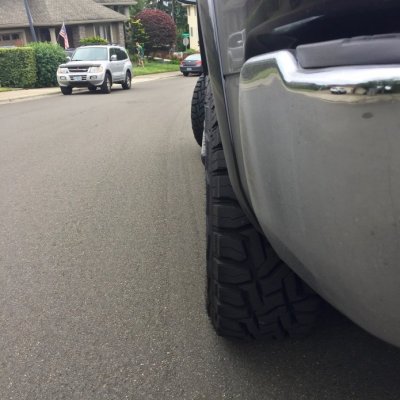

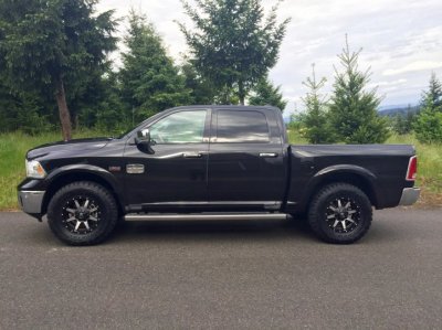

Once again would greatly appreciate your help. I recently had a set of 18x9 Fuel Maverick D537's on my truck with a +20 offset. I run 35x12.5R18 Toyo RT's. As you can see in the pictures they are flush with the fender if not a little tucked. I told the guy at the shop I wanted them to stick out about an inch or a little more and he obviously didn't follow my lead in that. He wasn't a huge fan of spacers either.
He called Fuel Wheels and they said we could return them and get a different set of wheels with another offset. What would 18x9 -12 look like on my truck? The other option in the D537's is a -44 offset which i think would be way much. How far would they stick out (would I need a 4" kit?), and would I need to switch out my factory fender flares.

-12 would stick out another 1.25" than it does now.

Definitely what Passive stated. Go with the -12 offset to get your wheels out the way you want them. Also, go with a 4" Zone kit. I absolutely love my Zone products and I'm sure you will too. Oh, and good choice on the tires... :waytogo:

+20 to -12 would be 1 1/4" further out from your current setup as stated before.
-44 would be 2 1/2" out from current setup.

They make your rim in a +1, which would be 3/4" out from current setup
