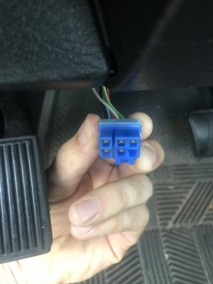

i have a 2005 ram 1500 4.7 automatic quad cab. I’m trying to find the plug to plug in trailer brake controller . The only plug I’m finding is a blue plug. Everything I’m finding online is saying that’s not it that it should be a white plug. Can someone please tell me which plug it is and possibly the part number or site to order it from. Thank you

I recently bought a brake controller from etrailer and it came with a jumper wire. One end pluged into the control box, and the other end pluged into that blue connector you are showing in the picture. Hope this helps.

some of the cheaper trucks aren't wired oem fyi. but if the blue plug fits use it.
