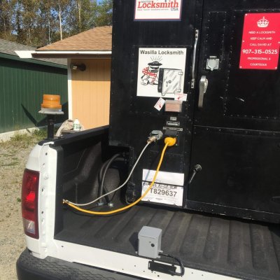

I'm looking for a accessory wire in the bed area for my aux heater. Can someone give me some information on where one might be located????
Do you know if the plug in for trailers aux power shuts off or stays on?? o_O
I'm up for brainstorming. :)
Thanks. ;)

I was able to use a small accessory wire (not being used) under the drivers seat where my inverter is located, now installing the relay made my task easy peasy. :signs8:
i found a USA made one that works great. :party36:
