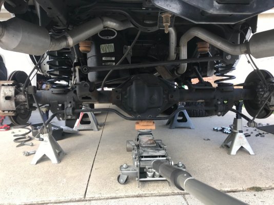

They’re just control arms, it shouldn’t be an issue to take them off and reuse them, you don’t have to touch them to take the springs out though, do you have 2 floor jacks and 2 long jacks? The job couldn’t be any easier.
Put one jack under the diff and take your wheels off, lift, put the long jack stands by the frame, disconnect your rear trackbar from the axel (rear driver side), disconnect your rear brake line brackets, if you’re not changing shocks, I think just removing the shock lower bolt could do the trick, and let your axel droop, replace the springs, use the 2nd jack to line up the trackbar bracket once you’re done with the springs, lifting from the diff pinion and the axel underneath the lower shock mount at the same time, lift/lower each side as needed to lineup the hole.
Easy peasy. If you need to take the upper shock bolts out, harbor freight 6” adjustable wrench will be the perfect tool to fit in there.

I don’t have spring compressors either, but the rear is so easy, driving to oreallys to rent the tool would take me longer than just drooping the axle :)
You may need to loosen the lca bolts or disconnect the track bar, the axle won’t droop enough without it, at least in my case, and either way still a piece of cake, track bar is just one bolt, but you want two floor jacks, or you may need an extra pair of hands, or straps to put that bolt back, with the floor jacks is just couple of min.

I installed the Eibach coil springs this weekend. It was extremely easy, no spring compressor needed. Did not even need to remove wheel well liners. Jacked up rear at diff, removed sway bar end links, removed bottom bolt on rear struts, lowered rear axel gently using the floor jack, being ultra careful of the tension on the brake lines, and was able to remove the OEM springs and squeeze the new spring right in.
I will caution, the rear brake lines on my truck were NOT long enough to avoid breaking if I was to fully lower the jack and let the axle drop all the way. You either have to be careful not to lower the axle too far, or remove the rear brake calipers.
