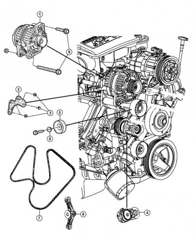

is it this one?
One end of the bracket bolts to the back of the alternator and the other on the block, the image below is for a different style of bracket, But I think it fits in the same spot. (#2)

@dangerous dave from what I can see, that's the way it goes.
Here is a Diagram showing the part and assembly breakdowns from Mopar.
Its weird that the part number and image don't correlate on some diagrams.
I also found this image of an alternator, I believe its for a Police Interceptor Chager with the 5.7.
But it shows a bracket that looks similar to the double fork part.

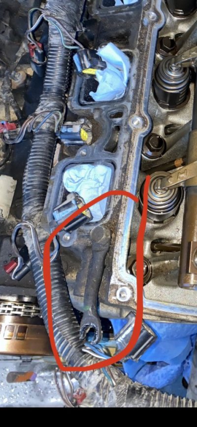

Here’s a couple pictures from my 09 hemi where it went on my truck.
