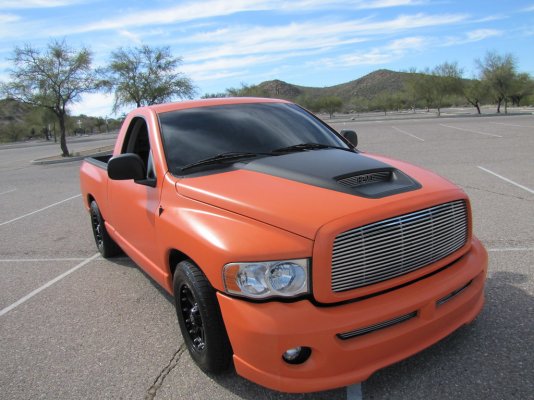

X3 Where I got mine. Be aware the TYC's while good quality, were patterned after the 2002 lights, which don't have the notch for the AIT. A dremel makes short work of this though (see the little white circle off to the right).
