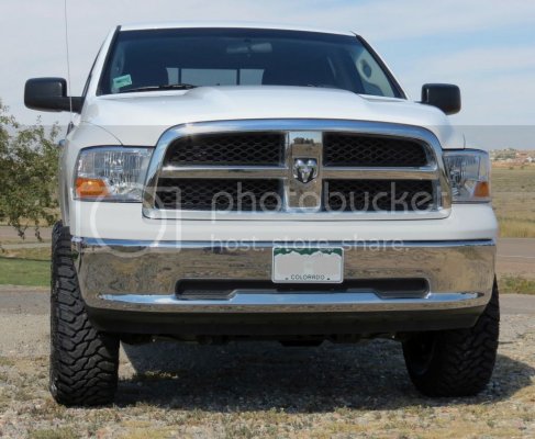

Granted I have a 6" suspension lift I thought that you would rather have a neg offset. I have a -12 offset for my tires. But, I'm sure someone else will chime in here in a min. Here is a pic of how my tires sit on my truck...

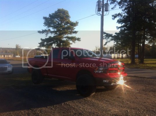

you need a negative offset, this is my truck with blisteins and a 1.25 bl with 17x9 with a -12/4.5 bs. ive got a good inch and a 1/4 with 35x12.5 cooper stts
depending on the tires and their sidewall lugs a 0 offset would be close
