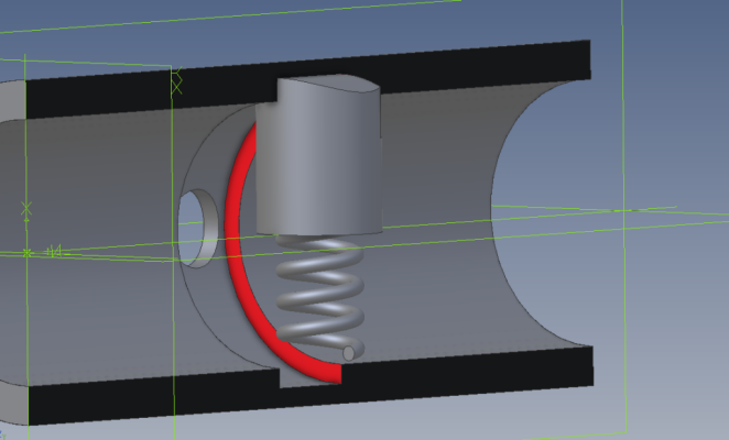

Here is some more info on it, credit to @EdGs from back in June. :
In the last post, Ed linked a video that gives a really good description starting at about the 11:45 point in the video.
But, the guy is slightly mistaken in 1 small aspect, but it's a technicality and not particularly relevant. He said that the inner cylinder rotates until a pin engages the hole, but that isn't quite correct. The hole is only for allowing oil in. The actual mechanical engagement is between the flats on the cylinder pin and the lower, planar, annular face of the circumferential groove inside the lifter body. The flats will engage the circumferential groove with any amount of rotation, or even no rotation at all. The pin is larger in diameter than the hole and could never fit anyway.
I fired up CAD to make it easier to visualize.
The plunger face, in red in this image:
Bears against the groove face, in red, in this image:

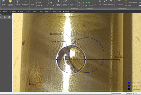

Using 2d sketch mode I used to chordal section of the pin visible in the pic to show the relative sizes of the pin vs the hole. It's evident that the pin is too big to fit through the hole.
