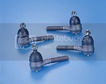

dang thanks guys i will check them out tomorrow, one more ? are they located inside the spring or around that area?? i know this is probley a stupid question lol
outer tie rod is connected to the steering rod next to the wheel? i guess thats what its called. inner tierod is in the other end of the steering rod that you probably wont see.
upper ball joint should be above the spring and lower on the bottom side of the spring.
anyone correct me if im wrong lol.
