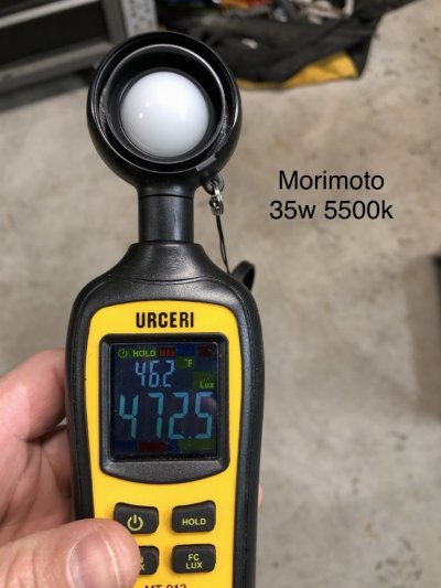

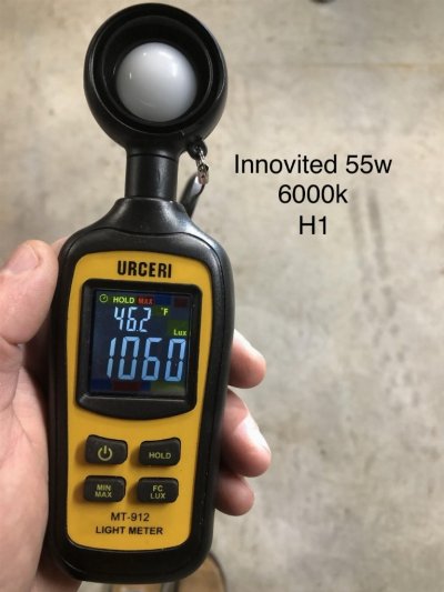

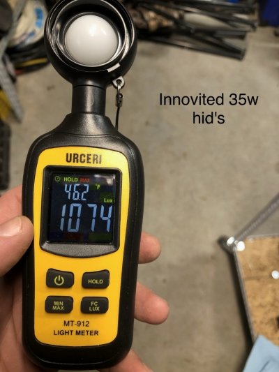

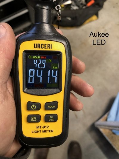

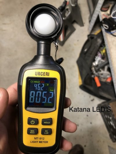

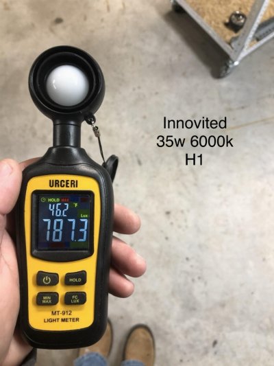

This isn't a technical, lab tested results thread but results I've come up with using some popular HID and LED kits being used mostly with members running the alpharex/modifystreet projector headlights.
I am currently building version 2 of my gen 1 2019 style alpharex headlights. I'm trying to put together the best budget build I can. So all the H1 products I recently purchased to see what would work and what will give me the best results. The H7 bulbs along with the Profile Pivot Hi-Lense was previously install by me. I was sent the 35w morimoto ballast by mistake so I wanted to test them. I'll be receiving the 50w morimoto ballast next week so I'll post those results. I'll mix and match the 50w morimoto ballast with the Innovited bulbs when I get them and will do the 35w morimoto ballast with the Innovited bulbs.
All readings are using a Urceri Light meter at ~20'
URCERI Light Meter Digital Illuminance Meter Handheld Ambient Temperature Measurer with Range up to 200,000 Lux Luxmeter with 4 Digit Color LCD Screen https://www.amazon.com/dp/B075DC6X25/ref=cm_sw_r_cp_api_i_mC7dEbM4CEM0K
At roughly 20'. Details posted with the pics.
H1 Aukee LED
Bi-xenon H1 7.1 Projectors
https://www.lightwerkz.net/index.php/components/hid-projectors/super-h1-projector-7-1.html
H1 LED Headlight Bulb, Aukee 110W... https://www.amazon.com/dp/B07V24F5GJ?ref=ppx_pop_mob_ap_share

H7 Katana Led's in Alpharex original projectors
KATANA H7 LED Headlight Bulbs - CREE Chips w/Adjustable Beam - 12000Lm 6500K Extremely Bright Conversion Kit https://www.amazon.com/dp/B07J5CWZDL/ref=cm_sw_r_cp_api_i_k87dEbJFYCBN3
H7 Innovited 35w 6000k Hid's in Alpharex original projectors
Innovited 35W AC Xenon HID Lights"All Bulb Sizes and Colors" with Slim Ballast - H7-6000K - Diamond White - 2 Year Warranty https://www.amazon.com/dp/B07NCRMNFM/ref=cm_sw_r_cp_api_i_Xb8dEbFN9YBH7
Innovited 55w 6000k Hid's in Morimoto H1 7.0 Projectors
Innovited 55W AC Xenon HID Lights"All Bulb Sizes and Colors" with Digital Slim Ballast - H1-6000K - Diamond White - 2 Year Warranty https://www.amazon.com/dp/B07NCQFXSR/ref=cm_sw_r_cp_api_i_Wv8dEbE5JTJ4V
Morimoto 35w 5500k Hid's in Morimoto H1 7.0 Projectors
https://www.lightwerkz.net/index.ph...bi-xenon-morimoto-mini-h1-7-0-projectors.html
https://www.lightwerkz.net/index.ph...sts/morimoto-xb35-amp-hid-xenon-ballasts.html
https://www.lightwerkz.net/index.php/components/hid-bulbs/morimoto-xb-h1-bulbs.html

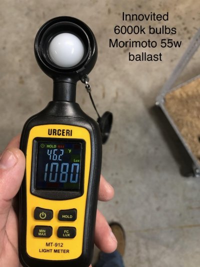

My 55w Morimoto ballast came today so I did a little more testing. Made sure that the battery I'm using was fully charged.
Morimoto 55w 5500k H1 Hid's
Innovited 6000k bulbs with the 55w Morimoto ballast
Retested the Innovited 55w 6000k
And tried the 35w Innovited ballast with the 6000k H1 Innovited bulbs.

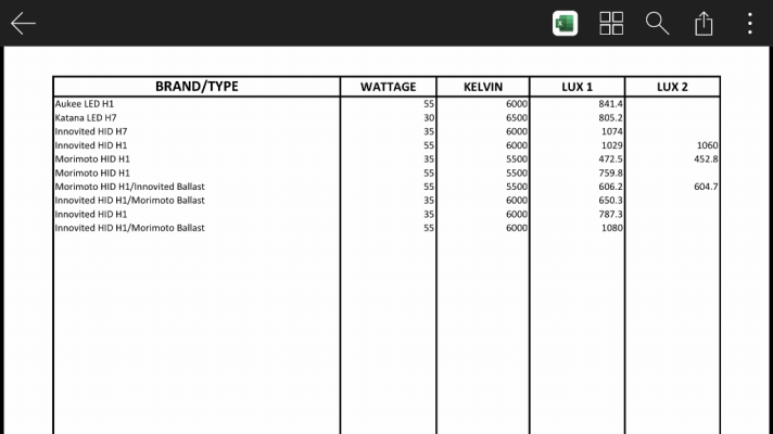

And these are all my results

Innovited 35w seems like a great alternative, considering the cost.
Sent from my Pixel 3 XL using Tapatalk
Absolutely

Are the h7 results using the projector "lens" that came with the headlights? And the h1 results are using the morimoto mini?
1500ram12
1500ram12
Jan 23, 2012
5,487
2,432
2005
5.9L Cummins
Yes. The H7 tests were using the alpharex projectors. Everything else was using the morimoto H1 7.0 projectors except the Aukee LED'S. They were in a "cheaper" H1 projector. I linked everything with the pics in post one incase anyone was interested.
